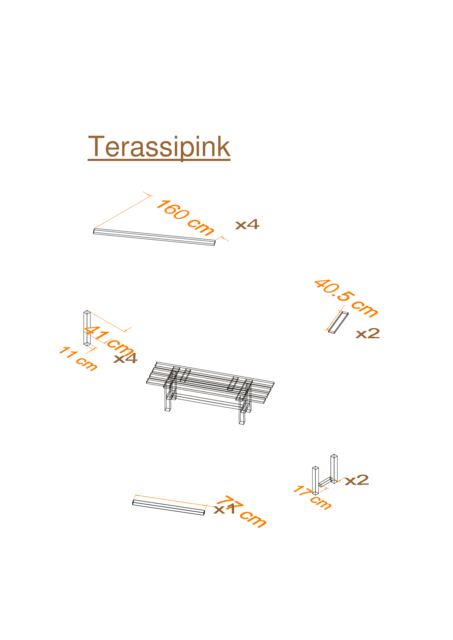

Hello,
I have a simple skectch of a bench i have been working on. So i thought my sketch to be ready and i tried to print it but only the solids printed not the colors i gave them. Then i read the forums to turn it into pdf, so that's what i did only to discover that it is without the solid colors. *Note it is viewd in isometric and displayed in full shading mode for the colors to show. Have i missed a step or what is the issue with it?

I have Viacad Punch! 9.
BenchSketch
Edited by user Thursday, June 25, 2020 2:24:06 AM(UTC)  | Reason: Tried to upload the color version but do not have a image format of it

I am clueless what to do. I tried filling the drawings in top view mode but nothing, since i already have them filled in trimetric. Then i upgraded the pdf print to pdf print995...something version, that only gives me the solids without fills. Maybe somebody with more experience with models could share their experience. I think i should be able to print the drawings out with color fills without any issues?

I have a simple HP Deskjet ink printer 2600 series for color printing. But in my opinion it should not make no difference what your printer type is. Since it is the file format that fails the outcome of the paper. As requested i can add my sketch plan for everyone to give it a try.

I made a test with SharkLT9, and this printed your sketch in a strange way, then i used the Photo Rendering Tool. Have your ViaCad a Model to SHeet Function? Or Photo Rendering?
