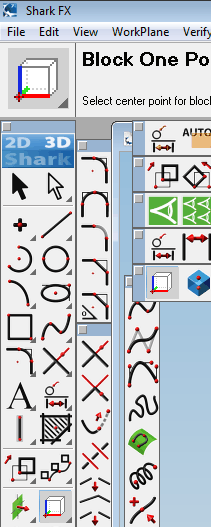

Just for fun... I changed the block one point icon in the 32 x 32 skins... it shows up in the vertical toolbar, but not at the top. Where is that changed? in the 64 x 64 skins?
UserPostedImage
Mike...
ViaCAD Pro 12 on Windows; Viacad Pro 14 on Mac
jol
#34 Posted : Thursday, January 13, 2011 5:52:01 PM(UTC)
jol
Joined: 2/26/2007(UTC)
Posts: 2,156
Was thanked: 1 time(s) in 1 post(s)
yes - that's right Mike !!

Nice Mike! Yes there are four icons making up a tool.
16-Tool cursor
24-Small Icon (Prefs:User Interface)
32-Large Icon (Prefs:User Interface) Default size
64-Prompt area icon
Creating a custom palette lets you specify any of these four cursors.
