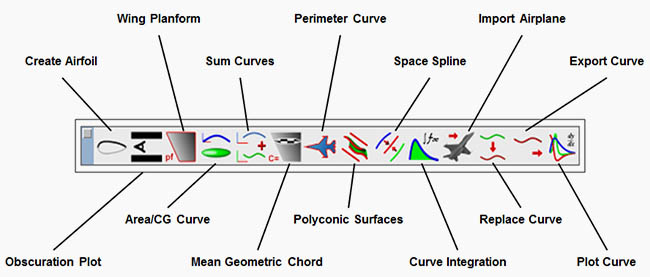

I looked around in the ACIS docs but have yet to find an interface into blending that would support a rho. It's all based on radius. And there is not really a way to add a new blend cross section with the api that I've found.
Conic curves are great. The first CAD system I did for Lockheed relied heavily on conics as typically most of your airplane is built from conic sections. I think the only outer contour surfaces on the F-16 not based on conics (polyconic surfaces) were the wing surfaces. Conics dominate military aircraft design for similar reasons you mention. You can change the rho value without changing the tangency at the ends. For area ruling, where you need to change the cross sectional area to minimize wave drag, rho value editing rocks. Our AeroPack addon for Darcorp supports polyconic surfaces, but they are limited to surface geometry typically found in aircraft.
http://www.darcorp.com/Software/AeroPack/
Tim

The Ployconic Surfaces and Space Splines from the AeroPack both look like they could be very useful for industrial designers who are looking to create smooth connected surfaces.
Are the Polyconic Surfaces from the AeroPack just surfaces, or can they also generate solids? (I know that I can always thicken a surface into a solid, but it is nice to not have to go there.)
Is there any way that Spatial could be persuaded to add Rho control to the API so that PolyConic surfaces could be created using the editing tools rather than from from separate geometry that is then joined to the main part?
I haven't used SolidWorks for a while, but there used to be a tool that allowed you to do exactly what I want using some preferences in the blend tool, so that the extents of a blend could be extended beyond the radius of the blend. Is there anything like that in the ACIS API?
Surfaces. If you need a solid, you can stitch them into a solid. But they would need more work to be used in consumer product design.
